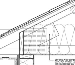

Corners and connections are where insulation and air barriers can have trouble.Compressed or insufficient insulation can cause cold spots, which lead to condensation, mold, and rot. Air leaks at this connection can cut the effectiveness of the insulation substantially. In cold climates, this is where ice dams begin.
To keep the air barrier continuous,span the wall sheathing over the framing connection and use adhesive or sealants at framing connections as shown.
