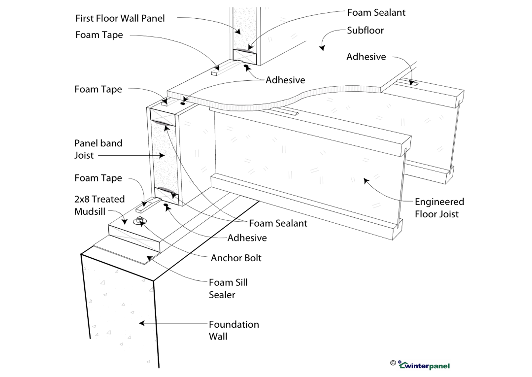

Structural Insulated Panels (SIP) can create a strong, well-insulated, airtight, building envelope. They can, however, be unforgiving when it comes to moisture management. Most SIP dry slowly if or when they get wet, so back-vented claddings, robust flashing details, meticulous sealing of penetrations, and effective spot/whole house ventilation are all essential.
Detail Caption:
The outer edge of the wall panels should be flush with the outside of the concrete foundation wall so that full support is provided. Secure the still plate with j-bolts or foundation clips.
