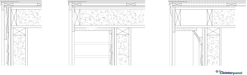

Structural Insulated Panels (SIP) can create a strong, well-insulated, airtight, building envelope. They can, however, be unforgiving when it comes to moisture management. Most SIP dry slowly if or when they get wet, so back-vented claddings, robust flashing details, meticulous sealing of penetrations, and effective spot/whole house ventilation are all essential.
Detail Caption:
Flush and overhanging gable-end rake details are shown. As with eaves, you have considerable flexibility in design.
