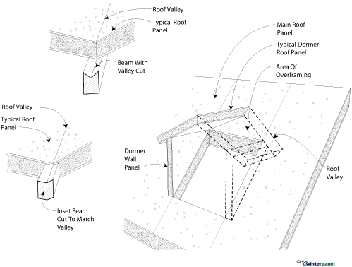

Detail Caption:
Of the three roof valley configurations shown, the preferred method (in terms of thermal, air leakage, and water management) is the supporting valley rafter, aesthetics permitting.
