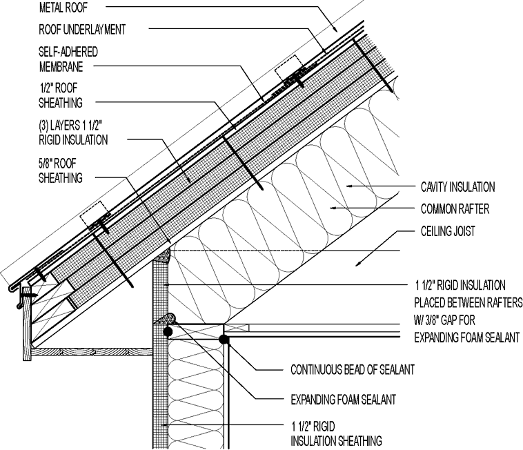

未放气的屋顶为寒冷的气候。金属屋面在Exterior Rigid Foam
Unvented roofs can perform wellas long as they are properly detailed to limit moisture transfer from the interior. Construction details vary depending on climate, but closed-cell spray polyurethane foam (specifically allowed by Section R806.4 of the International Residential Code) can be used anywhere.
