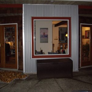

Faced with the same situation when re-siding my own house some years ago, I included pt wood 2"x4" trim around the windows.
Another area that's worth thinking thr0ugh when siding dormers is how the roofing can be replaced without removing the cladding to get at the flashing. It can be as easy as nailing the step-flashing to the roof, not sidewall, or better including a counter-flashing you can slip the step-flashing under.
Malcolm,
That turned out well and is exactly what I am considering as an option. Thank you for your photo. Well placed comment on the dormers, I also have six to address on a Gambrel roof at some point in the future.

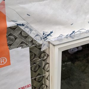

Craig, What width of trim did you use? I have found typical trim sizes ~4", leave little room to detail the new window flange back to the existing WRB, not to mention shingling the top flap of WRB over the window head A fluid-applied product to retrofit would probably make more sense here than peel and stick.
I used LP's 3.5" trim. We went basic with our materials (Lowe's, H-D) to reduce costs and lead times. Attached a picture of my WRB and window flashing detail. 1x6 furring on top, and trim to that. I don't have a good photo of that process as we were moving quickly during that phase.
