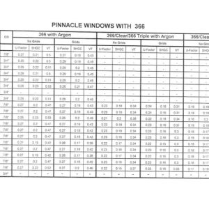

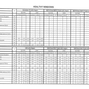

Has anyone had any experience with these windows? They seem very solid and have great efficiency ratings depending on the type. The prices so far are about 1/2 of what I’ve been quoted from Intus, and slightly cheaper than Softlites. They are on par with Anderson 400 series prices.

    They look like vinyl windows. I'm having trouble finding any information on the company's web site about U-factors, SHGC numbers, or triple glazing.
    [后来编辑:事实证明,公司确实制作了三釉窗,并且有关于U因素和SHGC号码的信息 - 这只是信息很难找到。]
  2. Mike M||#2
    They do indeed offer triple pane windows with U Values in the sub 0.2 range. I received these values with my quotes.

    迈克尔,
    Thanks for the info -- my mistake. The information is there -- just hard to find.

    我已经让双窗格的引号一直到这一点上的三个窗格。对于两个滑动门,2个滑动窗口(36x72和72 x 60双),4个固定窗格梯形。我还订购了四个大4'x6'图片窗口,但这对于三窗格或氪来太大了。总体而言,对于所有这些窗户的Krypton的三重窗格的成本低于10,000美元。
    我将订购4个72x60双胞胎的4个,以及浴室的较小窗口。总体而言,大多数窗户都是你的.19 SHGC的.2和空气泄漏.15 CFM / FT ^ 2。
    The other line they offered was definitely a bit more expensive, but the air leakage rates and U values didn't justify the cost to me. The main difference that I could see was the hardware and a few extra seals on the sill.
