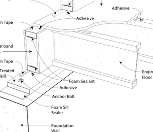

Structural Insulated Panels (SIP) can create a strong, well-insulated, airtight, building envelope. They can, however, be unforgiving when it comes to moisture management. Most SIP dry slowly if or when they get wet, so back-vented claddings, robust flashing details, meticulous sealing of penetrations, and effective spot/whole house ventilation are all essential.
Detail Caption:
If a timber sill is used, the panel attachment detail at the bottom of the wall is as shown. Rest the panel on a pressure-treated sub-sill and secure the bottom edge into the timber sill.
