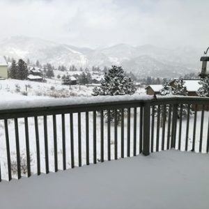

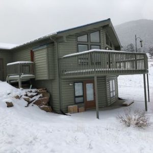

I've designed a few windscreens in NM, and I think a few outside pictures would help visualize your situation.
Armando, I have added two pictures - one showing the end of the house with the deck to be replaced, and a 2nd showing the fetch of the wind down the valley. No trees to shelter the house. My idea was to frame the new deck with strong two-story vertical posts and add a ramada roof and some sort of vertical deflector inserts to create eddies out at the front of the deck. I want the structure to spill the wind but drain it of energy across the face of the house. I don't want to interfere with the view any more than necessary. I just don't have any design reference for such a thing.
