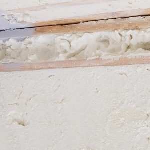

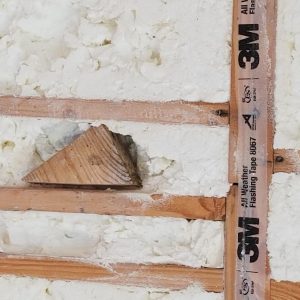

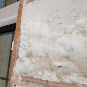

Jamie--Luckily my builder does a lot of homes, so subs aren't prone to walking if they want a steady stream of business. The owner of the drywall business came out, shook his head, fired the rogue temporary worker, and paid for the insulation to be redone. There was a crew there that afternoon to remove all the drywall for inspection and re-insulation. The insulator, who has been doing this for 30 years, said he has never seen anything like that. I attached a couple pics, and then the third pic shows how the perpatrator artfully filled the hole with a block before covering it up.
Pictures didn't load.
That last one. Sorry but I have to laugh. Seriously that little piece of wood doesn't look AT ALL conspicuous. *sarcasm.*
Sorry they are all sideways! Left is up. You can see the guys finger marks in the first pic.
