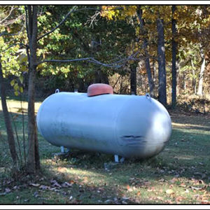

Propane is delivered by truck. As long as the roads are clear and the propane company hasn't stopped its delivery service, a propane truck can fill a tank in a neighborhood without any power.
However, I was assuming that the house would have a 500-gallon propane tank; these are very common in rural areas. I think that there are probably regulations that prohibit the storage of large quantities of gasoline in a residential neighborhood. A large gasoline tank is unusual and is likely to be expensive; large propane tanks are common.
Here's a photo of a 500-gallon propane tank:
