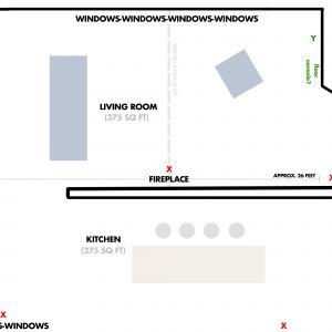

I’m wondering if anyone has any experience installing a heat pump in a vaulted area. The ceilings in our living room are approximately twelve feet, and I don’t want to install one there if we’re going to lose most of it to the ceiling.
The attached drawing isn’t 100% accurate, but hopefully it will at least give you some sense of our lay out.

I'm going to try that attachment again, and see if it works this time. If you have any thoughts on the ideal placement of a unit, I'd really appreciate it.
I have found minisplits in vaulted areas are very comfortable. I have two mini splits in vaulted areas...the extra air works as a buffer so there are not a lot of temperature fluctuations in the space. I think your best bet is to mount half way up the vaulted area, that way you are well covered for heating and cooling air flow. I don't think there is a good reason to do a floor console in a vaulted space.
