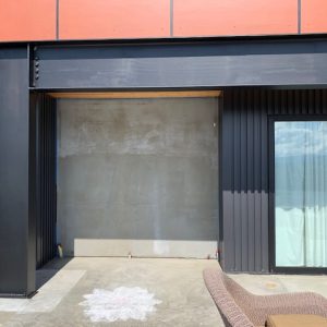

Thanks for the help on this Malcolm. Yes, I am planning on using trim head screws. However, I may need to rethink things a bit based on your last post. We live in the PNW as well - the Columbia Gorge more specifically. One of the walls is exposed to very consistent high winds and sometimes rain along with the wind. Construction wise, the builder put a good house wrap on before the stucco guy came and did his work up to the scratch coat before bailing. So that's where we are now.
I have no problem installing the battens before painting, however, I was unable to get the elastometric paint in a dark color so I ended up just buying regular brick and mortar paint in black. I suppose I could go buy some of the elastometric paint and do a couple layers of that and then the regular black paint over that if it would make a difference. I'm not worried about water getting through the wall as it stands now, but if the screws will allow water through I need to deal with that.
I've attached a picture to better illustrate what I'm dealing with. Seemed simply enough when I started this, but like everything it's getting more complicated as I go.
Any additional advice would be great.
Thanks!
Matt
Matt,
这取决于你愿意是多么挑剔。The small strips would work as long as there was a way to stop intrusion at the top. Something like a a dap of caulking to bed the top of each strip in could be fine. Hiding the strips makes sense if they are plastic. it would be really annoying to try and re-cover them if the black paint started to come off once everything was installed.
I missed your question about spacing of the supports. Typically you wouldn't want to go further that 2 ft oc, but with Ipe you might stretch that to one at each end and two intermediate ones. Going a full 5 ft might turn out pretty wavy, and with only a 1/8" cavity risks closing it off in spots.
Form the photo I think the open cladding will look great there.
