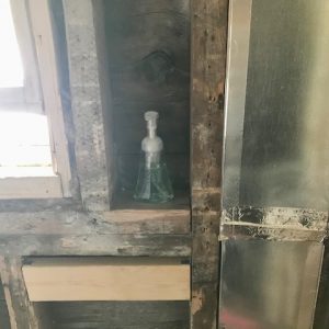

我们靠近佛蒙特/新罕布什尔州边境。我们希望在我们的1949斗篷的浴室中安装Cadet Energy Plus壁挂式加热器,目前正在挖掘(即所有空腔)。整个浴室中只有一个腔体,我们可以在满足所有制造商所需的间隙时安装该设备。问题:所述空腔不足以容纳罐头。建筑码说什么关于减少螺柱的*宽度*?IRC R602.6说在外墙中的螺柱(所讨论的一个)可能是最大25%的深度的缺口。但我找不到*宽度*的百分比可以被删除......?我们想要放置加热器的腔体宽6.1875英寸。可以衡量7.875英寸宽,逐渐逐渐变细至7英寸;换句话说,1.6875英寸太窄。 Can I cut 0.84375 inches from the width of the two flanking studs (left and right)? This way, the can (which measures 9.75 inches tall) will fit. Each stud has actual width 2.0625 inches by actual depth 3.75. So I would be reducing width of each stud by 40.9% (Actually, a smaller percentage—probably in the high thirties—after accounting for future drywall). Pls note that the licensed electrician (Master) we were planning to hire did not know if the Code allows this. A licensed general contractor we have used in the past did not know either. Our local building inspector is unreachable by email and never returns voicemails. The structural engineer we have consulted with in the past charges $300 per consult. If we had a long list of other questions, we would contact him. But we don’t. Nor do we foresee having questions for him in the near future. We know there are other brands of electric wall-mount heater (probably same clearance requirements / can width). Our neighbors have the Cadet Energy Plus; we played with theirs and like it very much, so we are wondering if we can legally install it in a “too narrow” cavity by making the cuts described above. Thanks in advance for any input.

    谢谢,比尔。我确实考虑了移动其中一个铆钉,但不能因为右手螺柱与超出它的HVAC管道占据了整个腔。左螺柱左侧有一个窗户。我们无法将此窗口螺栓移到左侧,因为我们已经购买了三个窗格窗口(更换了您在Foto中看到的那个),以填充粗糙的开口“outie box”和最小的制造商推荐的“Wiggle房间”“。在附加的照片中,我们要安装的空间加热器的腔体有一个泵肥皂瓶。

    所以这个问题在这里是那个窗口的顶部的顶部看起来像。这是从上面转移负载的东西,还是它只是为了窗户用作伴侣?
    你是将这个加热器放在肥皂瓶的水平之上吗?如果您将其放置在下面并渗透到该水平窗口,则需要在窗台下安装另一个支持。

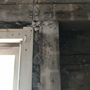

      谢谢你,CL。我们希望把墙上的加热器放在肥皂瓶的上方。我附上了一张显示窗口框顶部的照片。我想我们会采纳比尔和马尔科姆的建议,安装一个天花板或表面安装的加热器,而不是我们的邻居很满意的Cadet Energy Plus壁式加热器。它可能不是理想的,但浴室是如此之小,可选择的加热器放置非常有限。我们不愿意扩大浴室。再次感谢您的帮助。

        那个jamm明显携带从窗口上的标题中的一些负载。有点困扰是看起来它看起来像标题是2件刚刚左边的Jamb左边,或者标题无意中与其他作品无意中削减。希望标题中的那些削减是肤浅的 - 即不超过1/8“。
        如果是这种情况(切割表面)和头部的右侧是轴承到左侧的管道,你可能有一些灵活性,使门框更窄,适合您的加热器。
        您的照片没有显示出足够的区域,以确定,但由于它显示了延续了jamb的标题,我会猜测它要么脚趾向右侧向右侧的照片,或轴承在该螺柱上。
        拍摄整个区域的照片并发布,然后还将加热器配置绘制到那张照片的副本中并发布。如果您提供整个背景,这里的人可能会引导您 - 至少您将知道您尝试过,如果该加热器真的是您喜欢的。
