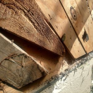

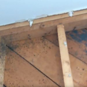

Dana, thanks for the quick reply. However, you didn't address my concern of the roach poop. The attached picture doesn't show the worst of it (mostly along top plate). Sorry, I should've been more specific about my concerns of the existing sheathing causing allergen problems if it is drying to the inside.

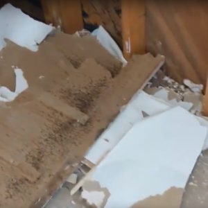

我添加了图片上面显示particles are already *in* the home on the 2x4s and back of the sheathing.
You guys keep missing my concern. I might as well use dirty diapers as the fibrous insulation in the stud bays.
Hi Jarrett.
I am no expert when it comes to this type of remediation, so, I'll say it like this. If it were my house, and I knew that I had solved the roach problem, I'd do my best to clean up the feces, and be comfortable insulating and closing up the wall without doing anything special to encapsulate the staining. I would be doing everything I could to air seal all six sides of the stud bays and in that way no (or little) airborne concerns would be reaching the interior. Your comfort level (and sensitivity, as Jon points out below) may be different and if that's the case, you may want to consult an expert of replace the sheathing.
Cleaning out the cavities and perhaps applying insecticide vs spray foam depends on how sensitive the occupants are.
I'd use unfaced EPS (moderately permeable) on the exterior - mineral wool is expensive and more perms than you want.
A blast with a steam cleaner would remove most of the particulate matter, a light spray down with a bleach mixture would sterilize it and remove most of the staining.
Air sealing it with open cell foam would pretty much lock it into place anyway. With no air moving through the wall (only water vapor and other tiny molecules) there isn't much stuck to or soaked into the studs & sheathing that will make it into the indoor air.

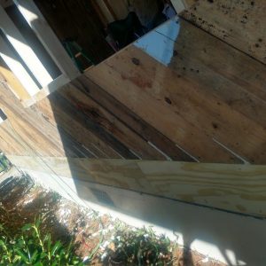

Current plan:
* Clean and sterilize stud bays (mainly for peace of mind)
* Repair bottom of sheathing with plywood as needed (see pictures)
