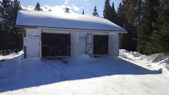

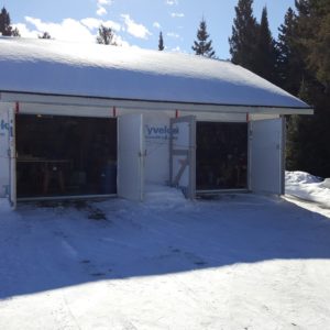

I built a pair of insulated stable doors (style) for my garage/workshop. I have 2x6 walls with insulated steel doors that purport to be r11 but that's just wishful thinking! They fit reasonably well to the openings but still were never up to the task of allowing me to heat the shop (I've added a pellet stove and run it at a glorious 65f when its -40f outside.... back to the stable doors, since my walls were 2x6 I had 6 inches of space in front of the overhead doors to fill with door/insulation. A fairly simple 1x6 frame and 4 inches of a mix or EPS and XPS (its what I had).. and the doors (which I built to provide 1/4" clearance open and close like a bank vault. They protect the doorway far better than the original doors since they bottom trim is outside the concrete so runoff from the door never uns under the door. I built stops for all 4 sides (including the bottom and stapled a strip of waste XPS to top and both sides and to the bottom contact strip of the door. As a result I have a slight raised (pressure treated) strip on the floor that the doors bump against.... the XPS strip acts as an air seal...and is cheap and easy to replace (I ripped em to size on the table saw).
Here is a picture of the doors before they were finished..
