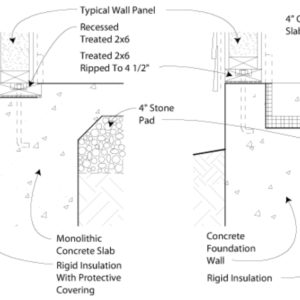

The detail in the GBA library (below) keeps the OSB skins of the SIPs elevated, so that the OSB does not touch the concrete.
