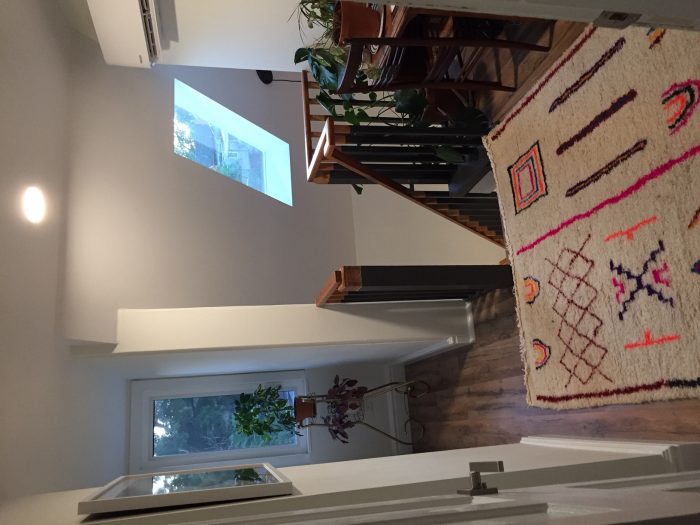

    在走得太远之前,如果您的房屋足迹与第二层+膝盖墙相似,我会问29K的热负荷4区的4区,带有带有双窗格窗户和基本绝缘墙壁的房屋。如果您以前有燃油使用账单,则如果与之匹配的话,我会根据该账单进行检查。
    The idea solution would be to get a ducted mini split that can be mounted vertically and mount it on the wall between the bedroom and the office. The ducts can be simple runs as they just poke through the wall on either side. You might need one longer run in the bedroom becasue of the width. The whole thing can than be walled in to look like a jog in the wall.
    This is probably more intrusive than you care, the less intrusive would be to go with a 2 zone multi for the second floor with a 9k floor console for the bedroom and 6k wallmount for the office. You should be able to put the wallmount on the wall beside the door to the office (see attached for similar install in a low 1/2 story, cutoff in the picture, beside the wallmount is the door). You can connect these to a MXZ-2C20NA2, no need for hyper heat as these will be used mostly for cooling.

    Akos, I appreciate your input. That ~29K load includes the first floor (~940 sq. ft, no wall insulation, mix of single- and double-paned windows) + an additional basement tv room (~180 sq ft). Sadly the placement of the door in the study wall in combination with the slope of the roof means a wall unit on that wall can only be place about 40" off the floor, blowing directly in someone's face. So I'm still vacillating on equipment selection for the upstairs, but I'm at least comfortable with the smaller air handler for the downstairs based on feedback here and Allison's article Kiley linked above.
