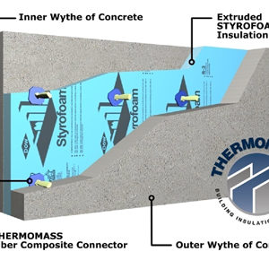

    最着名的墙壁系统,实现了你正在寻找的东西被称为保温系统。(参见下面的图片。)您可以通过致电800-232-1748联系Thermomass。
    Thermomass uses smooth concrete forms, not board forms, so I imagine that achieving your goal with the Thermomass system would be challenging. However, if price is no object, Thermomass engineers may be able to come up with a technical solution to your problem.
    您的建筑师和工程师也可能在墙壁中心使用板式和连续刚性泡沫来提出网站制版的解决方案。然而,这种方法有几个挑战,它不会便宜。
    如果您不希望Sky-High成本,解决您的问题的最简单方法可能是将墙壁隔热(具有刚性泡沫或喷雾泡沫),并覆盖干墙的绝缘。
