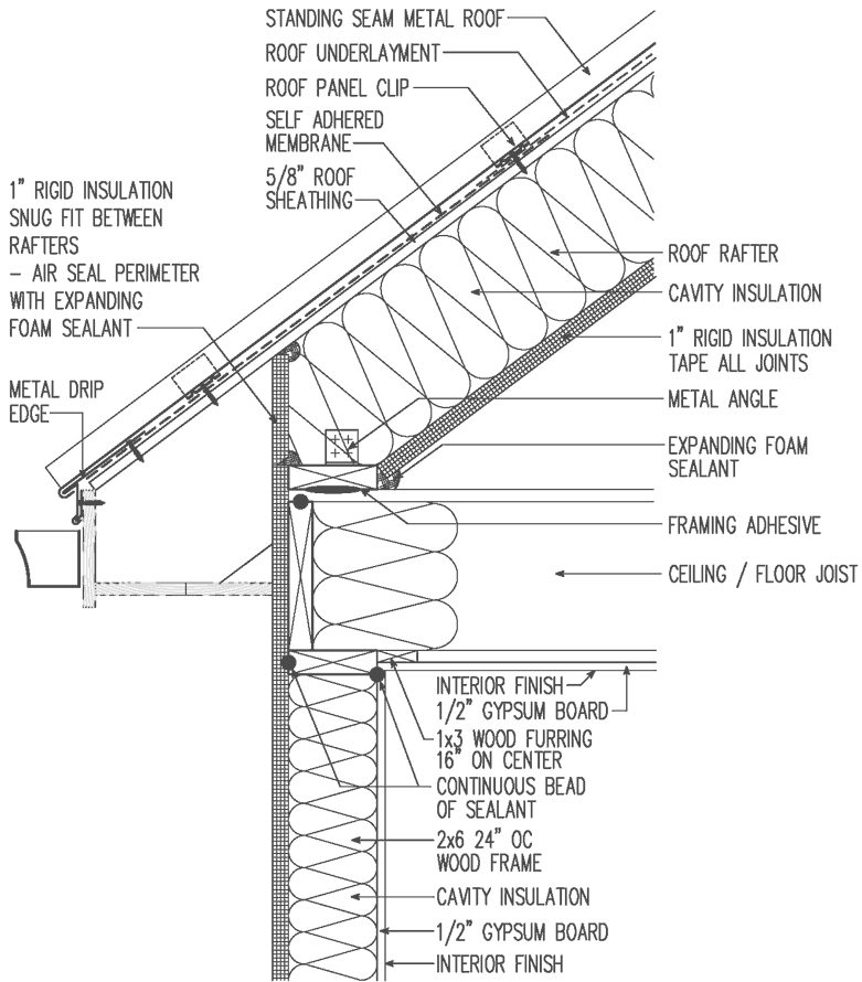

Unvented Roof for Mixed Climate. Metal Roofing.
Unvented roofs can perform wellas long as they are properly detailed to limit moisture transfer from the interior. Construction details vary depending on climate, but closed-cell spray polyurethane foam (specifically allowed by Section R806.4 of the International Residential Code) can be used anywhere.
