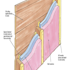

Thanks bill! Yes definitely an oddball approach. Sort of an experiment of the rain screen wall on a budget while trying to stay true to the structure! Haven’t had any water intrusion/ condensation anywhere yet in the two years since the sidings been up. Each time I’ve cut into the siding for plumbing and electrical everything seems like it’s in great shape. My big worry is what ac might do to the walls! Originally I was thinking about going no ac but my tune has changed after a few summers!
And yes! I was definitely thinking vapor open but air tight Housewrap was a good alternative to drywall. Any suggestions on types that would hold up would be awesome!
Another approach I was thinking about was a detail for old walls with no wrb. Essentially poly iso set on 1x for an air gap-“cut and cobbled” into the stud bay. The polyiso would take care of my air barrier issue and I love the idea of the sheathing having drying capacity to both directions. Is this a silly idea?
Any input is greatly appreciated!
