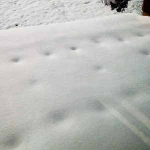

对于倒入墙壁的壁,无论是热等量还是热摩量,下落是由用于保持表单的断裂扎带带来的频繁的热桥。这些普通的钢带将引起冷水模式,就像我在屋顶上看到的那样(下图)。ORNL对中壁中的泡沫的热量损失进行了分析,该泡沫证明了整个壁r值的命中率是多少。如果我能找到它,我将附加。大约10年前,我一直在研究所有这些交替的东西,而硬盘驱动器很喘息。

I have attached my own photo of my own roof to show just how powerful the heat transfer is when using carbon steel screws. These particular ones are passing through 6" nail base into LVL rafters. The underside of the deck is a foam and batt continuation of the insulation profile. The snow is about 3" deep. Stainless screws would have been a wiser choice since the heat conduction is about half that of carbon steel. I would have also included a picture of the same effect on my standing seam roof panels when the morning dew will show hot spots. Unfortunately I don't mark my photos well and can't find it.
