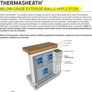

Thank that is what I read but then on the Rmax site for their product called THERMASHEATH®, which says it is a closed-cell polyisocyanurate (polyiso) foam core and it's the product data sheet for THERMASHEATH® is titled BELOW-GRADE EXTERIOR WALLS APPLICATION...
https://static1.squarespace.com/static/57a39be0579fb3a3a8540f56/t/5e84a111f7732f0997bfc172/1585750289979/Rmax+Thermasheath+Application+-+Below-Grade_2020.pdf
https://usa.sika.com/dms/getdocument.get/699fa898-04d5-40d3-bfde-15eaa6684fab/Rmax-Thermasheath-Product-Data-Sheet.pdf
on the Rmax site for their product called THERMASHEATH®, which says it is a closed-cell polyisocyanurate (polyiso) foam core and it's the product data sheet for THERMASHEATH® is titled BELOW-GRADE EXTERIOR WALLS APPLICATION...https://static1.squarespace.com/static/57a39be0579fb3a3a8540f56/t/5e84a111f7732f0997bfc172/1585750289979/Rmax+Thermasheath+Application+-+Below-Grade_2020.pdf
