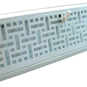

If it is a register for a forced hot air system like the one in the photo below, you can probably get away with a smaller unit.
Such a diffuser will reduce air velocity, causing the hot air to rise upward (useful under windows). Other designs move the air horizontally, increasing mixing and reducing stratification.
The diffusers are what Martin posted a picture of. Everything i can find says to buy them based on the cut out in the floor. The floor opening is 2" x 12" so I bought ones that fit that. No idea why a 48" long one would be necessary.

A 48" long one would be a good choice under a 48" window. Or get one with louvers that spread the discharge air.
