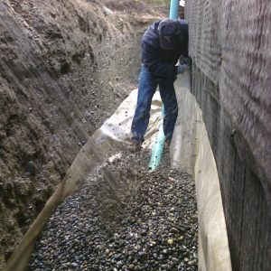

Outside footing drain burritto and mirror drain installed
What phenomenon are you concerned about? ie, what are you trying to avoid? Is not the cork very porous? BTW: In the pic above, I don't see a porous mat over the pipe. I believe one is usually used to keep dirt out of the drain pipe.
