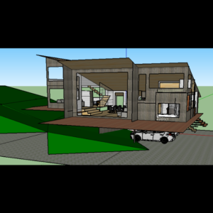

Hi Martin! The site we have chosen is at the foot of an exposed bedrock slope which emerges out of a sandy flat zone, in which we plan to locate septic&wellhead. proposed main living space would sit about 10’ above sandy plain... our rough sketchup plan shows the essential idea:

Thanks again. I guess the question becomes: is heat tape on external drain an unwise or uneconomical proposal. plumbing is not consoldidated in our plan which has bedrooms at opposite ends, but we do have elevation under the main floor to merge drains at grade...

那就是这个想法 - 一个绝缘的腔体从地板底部悬挂,可容纳排水口和/或供应,跑到机械室,一切都在地下。除非OBC以某种方式发生冲突,否则似乎是合理的。外部井口/泵浦空间的麻烦仍然需要加热
为什么不将所有地下管道从井中带到化粪池,然后通过坡度上的平板进入化粪池,进入房屋侧面附着的加热的机械室(看起来像倾斜棚)呢?然后,您可以将管道通过连接墙和室内虚假地板下的浴室和厨房的墙壁路由到房屋中。这样一来,管道就永远不会暴露于外部空气和冻结温度。
谢谢,我认为鉴于所需的长期跑步,我无法将排水管安装在虚假的地板上。还会大幅度增加成本 +施工时间,不是吗?
好..每英尺1/4英寸,您只看约1英尺的48英尺。
How much distance do you anticipate having between the tiles in your bathroom to the bottom of your floor joists? In other words, how large of an insulated cavity do you anticipate having beneath the surface you are going to walk on.
You may actually have a larger problem with the rapid drop at the local it leaves the house to get to the ground. That type of a drop may serve to evacuate the pipe of liquids and leave the solids behind. Have you talked to a septic company yet?
Ive been planning on 2*10 joists spanning girders spaced at 10’. but even with 2*12, i don’t see enough depth to facilitate the drains merging, elbows, etc. cutting into the floor structure so extensively could likely be problematic or prohibited, no? thanks
