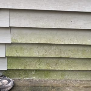

I have a small cottage in the Catskill Mountains of NY, with some fiberglass batting between the 2×4 studs and some mineral wool between the studs and above the ceiling (on the floor of very low attic).
当我克ot the place, one external wall had some green mold/mildew/algae growing on the vinyl siding. I removed some pieces and the wood underneath (which was a T-111 type siding) was dry and without any evidence of mold.

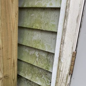

I am attaching a couple of close up pics of the mold (I believe it is) growing on the outside of the vinyl siding. This has been here for a long time and I have very recently opened up the area in front of where this is to more sun and air.

That doesn't look like mold. It's green, so it's probably photosynthetic (some kind of algae, maybe moss). It's hard to be sure from the pics. Scrub it off with some household cleaner, I'd probably use one of the Clorox cleaners in the spray bottle. Not a big deal, just don't use anything too abrasive that will scratch up your siding.

"Wet and forget" works well on algae, moss, mold and mildew.

I have the same type of algae on my vinyl siding, and based on a recommendation from one of my Fine Homebuilding colleagues, I use Mr. Clean Magic Erasers to take it off. They work like a charm and the algae stays away for at least a year. The other product I know people have success with is Wet & Forget.
I never thought to try those magic erasers on stuff like this. I always think of them as "get whatever my kid wrote on the wall off the wall" :-) I'll have to be more adventurous with those things now!
Bill
An application of Wet & Forget will be MUCH quicker than the magic eraser. Just spray it on and move on. Algae will be gone in a month. I'm betting this is on a north facing side of the cabin?
