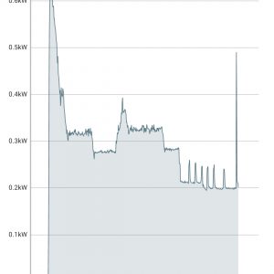

You should invest in an electricity monitor for your mini splits. You can see exactly how they modulate. Seeing how they run has been a massive help in running both mine efficiently.
Here is my first floor 12k unit that I had programmed to come on at 3:30 this morning. It will draw 1200 watts at max capacity and 180-200 watts at minimum modulation. The spike at the end to 500 watts is done to send oil through the system to lubricate the compressor at minimum modulation.
