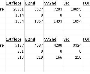

        Attached is what the Man-J shows.

          确保你的男人j是正确的。延期损失似乎很高,那么BTU的数量达到大约90cfm /楼,似乎有点高。
          Your main floor losses also seem high compared to the 2nd floor for a simple box shaped house, they should be pretty close.
          假设每个楼层都有1500平方英尺的墙壁,带有20%的双窗格低级窗口(〜R4)。关于R20壁组件的墙壁(3.5“CC SPF + 2”Batts)。0F设计温度,所以70F Delta到室内。
          Walls 1500 * 80% * 70 / 20=4200 BTU
          Windows 1500 * 20% * 70 / 4=5250 BTU
          Add in some air leaks, take away heat generated from equipment/lighting/people, you are nowhere near 20000BTU.
          Splitting the 2nd floor up makes only sense if you have a lot of glazing on one side and there is significantly different heat/cooling load throughout the day, otherwise I would stick to one zone.
          You can definitely put each floor on its own zone, just make sure the equipment is sized for it. Based on the rough ballpark above, you are looking at 1 ton hyper heat per floor.

            Ventilation in the current analysis is by a LifeBreath Max 155 -- not sure if that helps explain the high ventilation loss.
            As you very closely assumed, the 1st floor has 330 sq-ft of window glass and 11' ceilings -- does that explain the higher loss compared to the 2nd floor which has 280 sq-ft of glass and 10' ceilings?
            But, the 1st floor total wall (include the windows/doors) is 1738 sq-ft (45x34x11). The 2nd floor has 1580 sq-ft (45x34x10). The 3rd floor has dormers on each side, so I would approximate the wall area (vertical area) at under 1000 sq-ft.
            这崩溃了:
            1st flr: 1408 wall; 330 glass
            2nd flr: 1300 wall; 280 glass
            3rd flr: 880 wall; 120 glass
            The second floor is not split such that one side is South and the other North -- it is split East-West. I think this would eliminate the explanation of glazing. I think the explanation is that the AHU can't move enough air for the entire floor.

            The high ventilation loss could be explained if someone put in the ventilation rate of the LifeBreath but didn't account for the fact that it recovers most of the heat--84%. So your actual loss should be maybe 16% of that.

    The Max 155 is around 70% efficient, this means at 150CFM you loose 3500BTU when it is 0F outside. 150CFM is only needed for a house with a lot of bedrooms, something with 4 to 6 bedrooms would only need to run the unit at 100CFM, so 2500BTU.
    Your actual wall sqft is not that far off, although the one of the 3rd floor is a bit trickey since there is a lot of roof area as well. Either way, I doubt you are in the 50000BTU range for the whole house, especially with SPF in the walls/roof and new low-e windows. I'm assuming your basement is insulated, if not, that can add a fair bit of heat load to your house.
