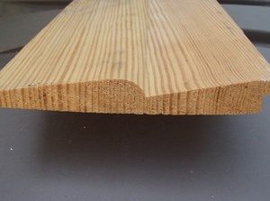

Regarding the siding: I think it's referred to as novelty shiplap with a double cove profile. Example is attached. Roughly 3/4" at the thickest point and 1/2" at the thin point of the profile.
Would a competent builder/remodeller be able to pull off the old siding in sections and replace with modern sheathing, so as to avoid removing the shear strength from too much of a wall at one time?

I don’t think that style of siding is adding much shear strength. Normally you need diagonal bracing or large panels (like an uncut sheet of plywood) to provide racking resistance. I don’t see any reason a good builder wouldn’t be able to remove what you have, but you’re almost guaranteed to have at least a few of the original pieces get broken or at least damaged in the process.
