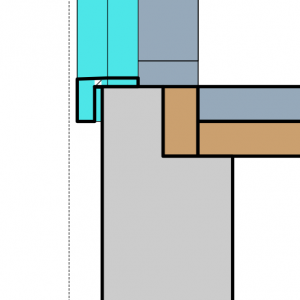

Thermalbuck Brinc BP.: Can the sill piece of Thermalbuck be attached directly to the concrete? Since the concrete slab will be the floor, I'm concerned with the trip hazard presented by 1.5" material + 1/2" Thermal Buck + door sill. Is ThermalBuck suitable for sill support only up to 1" thickness foam? See attached image and confirm that this is what you're suggesting.
Roger Berry:是的,1“总泡沫。这是2x6螺柱中的绝缘之外。因为这是我的第一个构建,我不想太壁垒太过墙,可能是打算的。我的担忧不是那么大量的能量损失,但是......门槛区域在冬季时太冷,形成了凝结。
