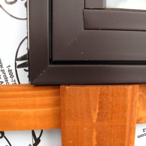

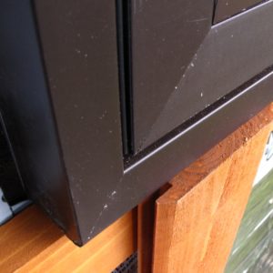

    I am attaching two views to illustrate. As Martin said, I need to extend the sill from the window to allow water to be diverted over the face of the siding. As it is presently, the distance from the face of the flange to the outside of the window is 1 1/4", while the sum of the furring strip and siding is 1 1/2". I wanted a modern style trim and preferably with metal, rather than the traditional wide wood trim most contemporary homes have. I have looked for dark brown flashing at the stores in stock and haven't seen what I want. Any suggestions on developing this detail?

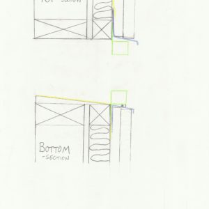

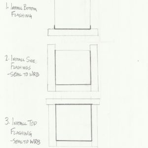

  5. Trevor Trainor||#5
    Steve- Hopefully these quick sketches help. The top and bottom flashings need to be sloped. You could use the bottom flashing profile for the sides if you wanted, or a 90 degree bend would work too. You will need to seal the top and side flashings (but not the bottom) to your rain control layer with sheathing tape or peel and stick flashing. You could use backer rod and caulking around the perimeter of the window, but it is not necessary as your rain control layer and drainage gap will drain any water getting into these areas down the wall. It also important that water can exit and air (but not bugs) can enter the gap below the bottom of the siding. This can be accomplished using bug screen to cover the gap at the bottom.
    Trevor
