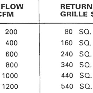

In general, the size of the grille is the same as the size of the return duct. An 8x14 grille needs an 8x14 duct.
To make sure that your return air ducts are adequately sized, though, you need to do some airflow calculations. Return airflow is equal to supply airflow.
If you know the airflow of your system, you can consult the chart below.
Note that some homes have only one return air grille, but better systems have multiple return air grilles.
