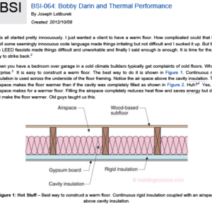

Joe L. says that insulation works better if it does not touch the floor. He just wants the edges closed off well. He says the floor is warmer that way because the space just below the floor is closer to the room temperature so the floor is warmer that way.
There are I joists that run quite large that are not open truss style.
Joe's yapping all about this topic is here...
http://www.buildingscience.com/documents/insights/bsi-064-bobby-darin-thermal-performance
