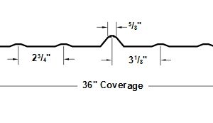

Center of home is Unvented Cathedral Ceiling with Closed Cell (possibly flash and batt to reach R value). On top of the sheathing will be asphalt felt, then metal roof. We purchased the Classic Rib from Metal Sales.
