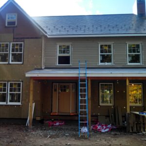

I just used a sister product "RoofAquaGuard BREA" under my metal roof.
http://www.roofaquaguard.com/products/RoofAquaGuard-BREA/
As you can see in the picture, the metal shingles have been installed on the main roof, but the standing seam hasn't been installed over the porch so it isn't damaged by ladders, etc.
