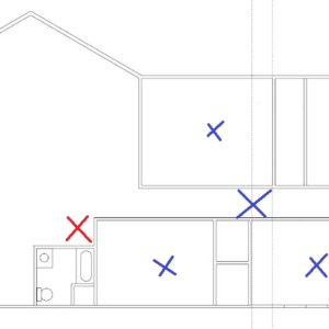

Here is the floor plan, the red X’s are non-ducted and blue would be ducted and the location of the common condenser coil:
The floor plan might help.
