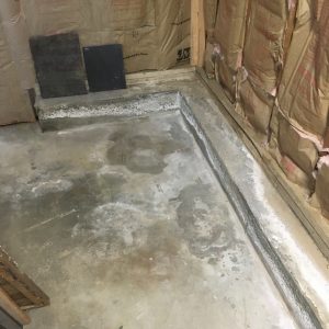

Thank you for the advice. Maybe these photos will help?

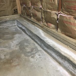

one more
Lstiburek is adamant about not putting plastic sheet on concrete (because of mold risk). A fully adhered coating is better.
