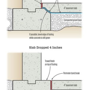

First of all, you should read this Q&A from theJournal of Light Construction:"Dropping the Level of a Slab."(See illustration below.)
If you don't want to remove and re-pour the footings in the middle of your slab, your only other choice is to leave them as is -- the footings will be little square boulders poking out of your floor -- and box them in with new columns.
Thanks but that does not help. Each center footing is 4 ft x 4 ft, making boxing not an option.
(BTW, I'd disagree with your referred article, regarding its assertion that no lateral forces are present on a basement slab. But that is a separate discussion.)
