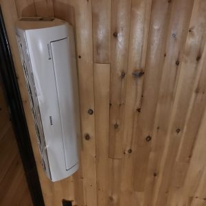

I currently have a ductless mini split installed at my cabin, the air handler is located in the living room on the main floor, is it possible to move the air handler to the in house garage located directly underneath? It would be installed on the same wall directly underneath.

You can absolutely move the indoor part of the system around, but it will require reestablishing drainage lines and I was told may require an HVAC tech to refill, purge, bleed, or do something similar to mess with the refrigerant.
It's an in house garage, you can gain access via the main level, garage door or side entrance door. So it's not a good idea to change location of the inside unit? I may not be providing the most accurate information as I am not that familiar with these units, I have attached a pic of the inside unit. The unit and the wood-stove are located in the same room, if possible I would rather move the unit instead of the wood-stove.
