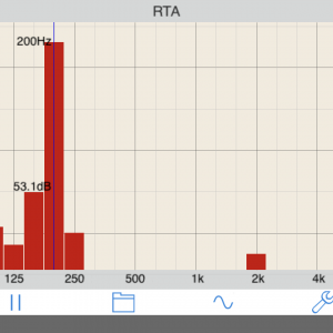

I installed a Gen 5 about a month ago myself in my basement and yes it is noisy. It is not the same noise as your refrigerator as I had hoped, mine has a nasty peak at 200 Hz, that frequency is about 15dB above all the other frequencies which makes it more annoying because a refrigerator has equal energy across the frequency spectrum which gives it a more "pleasing sound". I measured my unit at 62dBa 1 meter from the unit, but I am getting 53dB at 200Hz in the floor above the unit (see pic). 53dB might not seem bad but since it is only at one frequency it does sound annoying to me. Years ago I was a sound engineer and one of the things I had to troubleshoot was 120Hz hum in sound systems, so my ears are tune to that frequency and 200Hz is not far from 120Hz hum. That being said my wife has never said anything about it.

I also installed a gen 5 last week and the 200hz tone is LOUD. Contacted Rheem and they seemed to know about it (tech mentioned that frequency specifically) so will swap out for another unit, from a different build date.

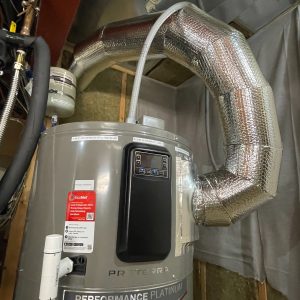

Sorry it has been awhile. I didn't work on the noise issue but I worked on vent the exhaust to my crawl space, after I did that I noticed the sound was better, so when I measured 200Hz at the locations I tested before I noticed an 8dB improvement. As you can see in the image I also added insulation to the duct work which might have helped. Now I am thinking I should duct the intake as well.
