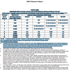

I'd use Table 2here. With your Intello, rainscreen and verified air sealing, it should be more than adequately conservative.
Jon R,
Thank you for the response. From my reading and understanding of Table 2. Which I attached a screen shot of, I am thinking that either my R6 or R12 exterior insulation over my R23 batt insulation would be fine. Am I reading that correctly?
Yep, .2 x 23 = 4.6 which is < R6. It even works if you conservatively use Zone 6.
