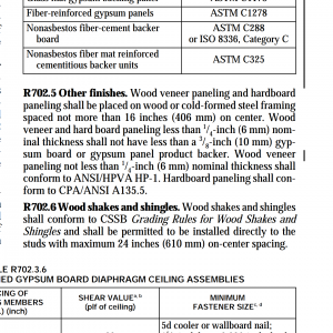

I too had a question about this. I know Schluter allows kerdi over drywall but does R702.4.2 preclude this install?
Thank you,
Kevin
Kevin,
R702.4.2 lists materials allowed to be used as tile backers. But the gypsum isn't the tile backer, it is the substrate behind a proprietary tile backer (Schluter's membrane). You could use anything Schluter allows in their installation manual.
