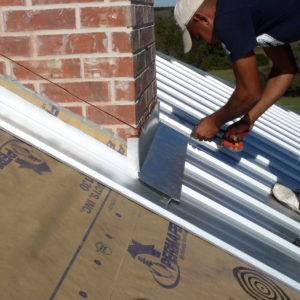

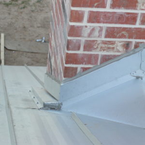

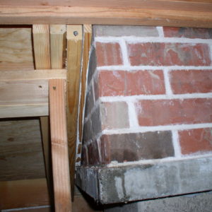

    6) See attached photos. Note that leakage is coming from between brick and brick ledge. This was after a fairly light, but sustained rain about a week after the bricks were set. The photo was taken prior to spraying in the roof insulation.

    The problem you describe is common. Few roofers and few masons understand how to flash brick chimneys.
    砖贴面始终泄漏 - 水通常在雨后沿着砖的背面跑下来 - 所以如果没有闪烁的系统,那么旨在将水从屋顶线上的外部驶出,那么当然是水将进入你的房子。
    You have three choices;
    1.不要做任何事情。这被称为“监视等待”。
    2.尝试一个封口机。大多数砖专家讨厌封口机,因为他们有时比良好更弊,但这种选择比撕裂你的烟囱更便宜。如果您想尝试封口机,请选择硅氧烷产品。
    3.将烟囱撕成屋顶线下方,雇用一辆经验丰富的泥泥泥,以通过铜穿过烟囱闪烁重建烟囱。
