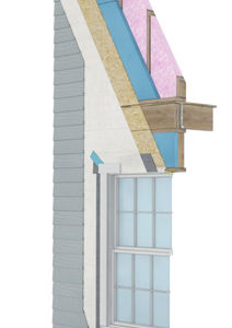

I don't know much about it, but I just learned about "Extended Plate and Beam (EP&B) wall system" because it's on the schedule for an EEBA conference session. Seems like it accomplishes what you're looking for (Simpler exterior / window detailing) while still providing room for exterior rim board insulation. Window bucks and top/bottom plates are the only portions that are not covered by foam.
I'd top it with Zip sheathing and it should be just as air tight. No benefit of a rain screen gap though.
Dwight,
I'm not familiar with the "extended plate and beam" system, but I found this drawing online. This particular illustration doesn't appear to show any exterior rim joist insulation.
