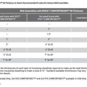

    Roxul has published a design guide with advice on continuous exterior mineral wool panels up to 12 inches thick (see table reproduced below).
    Here is a link to the design guide:Residential Insulated Sheathing – Design Guide.
    For more information, contact a technical help representative at Roxul. (The company now has a new name: Rockwool.)
