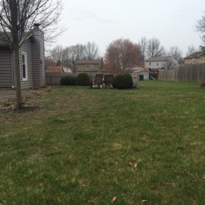

Most of the yard slopes toward the house, which is why I installed those drains/put the membrane on the wall. I live in Ohio, so we see it all... lots of rain at times, snow, you name it. There is a lot of clay in the yard, and it seems to turn into a soup kitchen during heavy downpour.
My yard sits lower than my neighbors' on each side now, so if I went to lower grade, I am not sure what I would do to keep their yards from becoming a dumping ground into mine. I'd contract someone of course, but not sure what techniques would be feasible since they are all sloped at me.
Attached a picture for you of the side view of that original set... it's subtle, but does head toward the house.
Where does the drain drain to? I assume you are talking about the footing drain and/or the downspout drain. It might be possible to have the newly lowered grade drain to the same place.
我沿着粉底墙有一个法国排水管,将凹槽连接到落水管,然后向左转(看到烟囱),然后将evacs送入通往街道的管道。
From the start of the overhang to the furthest outward edge of the gutter is right about 20 inches.
