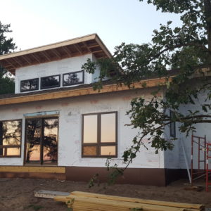

I purchased Alpen windows and a high performance entry door for our home in North Central Minnesota zone 6, 46 degrees N. Passive solar. 1,320 square feet. Mine is a sordid tale when it comes to Alpen but also a story of hope.
1. Typical turnaround from order to delivery, I am told, is 9 weeks during this year's building season. Our windows were still not available after about 11 weeks after ordering. Subsequently, the company upgraded us to the 725 Series that were available. I further negotiated upgrade of two windows to the 925 Series. Package includes fixed, casements, and awnings. One hitch. 8 of the elements in the windows available for delivery had flaws, ranging from imperfections essentially not visible to the naked eye to one broken pane. Meanwhile, our contractor was poised to de-mobilize resources (aka pull of the job) because of the delay.
I took delivery of the windows as is. Yikes! Yup. That's the choice I made. Alphen claims that they will send a certified glazier, reportedly in mid-September, to replace the flawed units - without impacting performance, I am told. :-) or :-( Time will tell.
2. I like that the casements have 3 locking points. Firm, tight, seal. The crank mechanism feels pedestrian to me. Clearly not a smooth working, highly refined hardware. Tough, long lasting? TBD.
3. The sliding glass door feels a bit tight, but very solid when opening or closing. Does tightness equal well sealed? Perhaps.
4. The entry door just got hung today. It's beautiful. It too has 3 locking points. The R rating of the glass is about equal to the insulated fiberglass door. Thus, adding a full length glass for the luxury of light in the entryway is a negligible hit in performance. I have yet to test how well the door operates.
Epilog: My wife and I are well into our sixties. Neither of us have ever lived in anything remotely resembling a high performance home. We have fought the good fight on this construction -- constantly pushing and pulling against budget and performance. We have been fortunate to have problem solving contractor employees who have helped us find creative solutions all along the way.
Will our Alpen windows kill our dream? I don't think so. Albeit long after I am gone our children may have a different view. Meanwhile, I fully expect to look out those same Alpen windows this winter onto a frozen wonder of lake, trees, and a Minnesota sky and be warmer, more comfortable than I have ever been in my many years of living northern winters.
Construction progress as of about one month ago. Tip of the hat too to Martin, Dana, and others who shared their knowledge.
I forgot to mention that our windows got hit hard with stiff wind and golf ball sized hail several weeks ago. The windows frames did not suffer a single dent.
