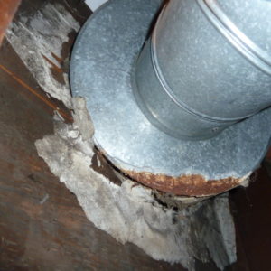

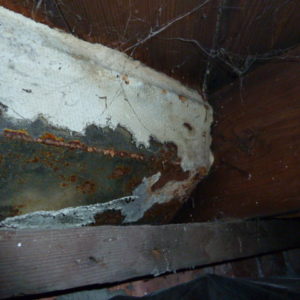

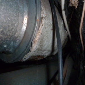

The guy was knowledgeable and looked around and pointed out that we have asbestos ‘paper’ wrapping the old part of our forced air ducts that we should paint over with an oil based paint to ‘contain’ it.
Which got us (wife and self) thinking…if we want to keep asbestos out of the air this is the absolutely worst place to have it, and by painting the outside we are not really addressing the real problem inside the ducts that are blowing this around the house. It’s my understanding that this was applied to seal any gaps in the sheet metal, so those gaps are now where the asbestos mineral is entering the airstream and it really needs to be removed altogether.
So I’ve called an asbestos removal company and am waiting to hear back from them. The only good thing is that it is not all of the ducting, however it is some of the hardest to reach ones, like the one running upstairs enclosed in a wall.

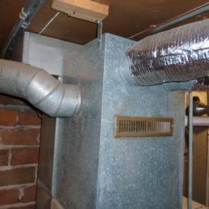

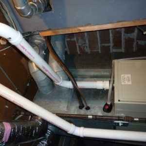

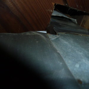

Just a bit more info. there is no insulation in our case (you mention insulation). Just this paper, which we haven't had tested, just the radon guy said it was asbestos - which I'll assume it is for now.
You can see all of the easy access ducts were replaced when the furnace was replaced by the previous owners it appears. We've been here 6 yrs, but never spent any time in the basement and so this was never on our radar of issues to be concerned with until now when we are considering some renovations to turn it into useable space. Anyway I thought the pics could be useful, and as I said the white paper is mainly away from the furnace as the pipes head into walls and hard to access areas.
