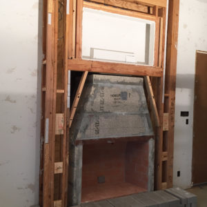

It's a modular masonry fireplace (Isokern).
它的2倍与烟穹顶和火盒脸相融化。
烟穹面的脸部被评为零间隙。
The framing will be sheathed with 1/2" Hardi 500. The Hardi will also lay flat on the smoke dome.
每个制造商的说明中的火箱周围的火箱将减少到8英寸的间隙(他们认为Hardi是“可燃”)。
Hardi将使用为水泥板制成的背螺钉连接到框架上,每个Hardi推荐(8“我想,也许6”),我必须检查)。
The manufacturer says that 1" drywall screws may be used to attach to the smoke dome. I've requested clarification from the manufacturer---can't find 1" drywall screws and if I could, I have concerns about their performance in an碱性环境。无论如何,我有点担心会拧入烟穹顶,但是如果我不这样做,我的哈迪的依恋仅限于木材框架。

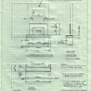

请参阅随附的照片和草图。
